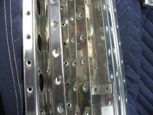

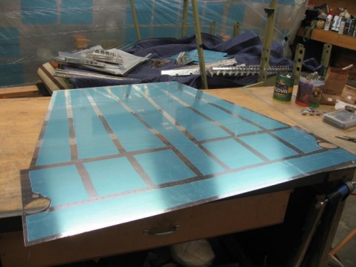

Brief Description:  Forward fuse bottom skin prep.

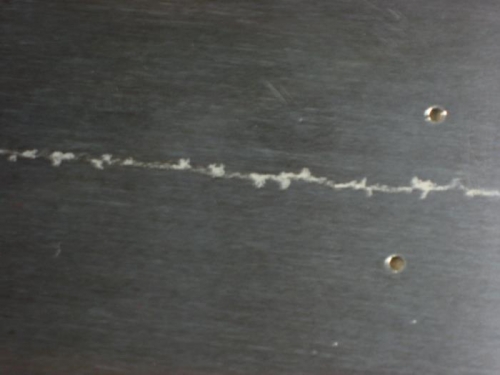

Forward fuse rib deburring and bottom skin preparation. There was some surface corrosion on the inside surface of the skin. The skin was covered with the blue vinyl while stored. I have found some corrosion like this on other pieces at their edges, this is the first time I found a trail like this across the surface under the vinyl. I used the scotchbrite wheel to take this off, it comes off easily and will be primed over.
