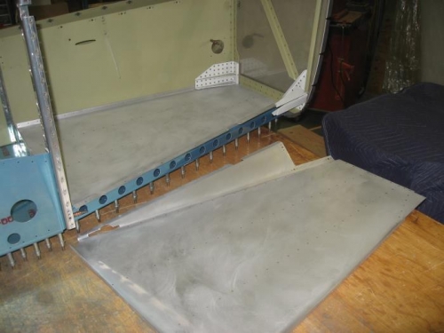

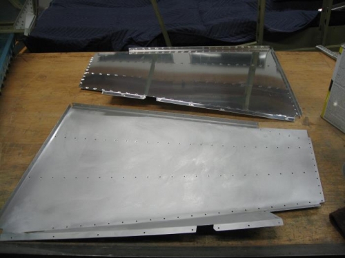

Forward cabin floor panels
Drilling and surface prep of the front floor panels. I treated these the same as skins that are too large to alodine and I just used the scotchbrite pad on the electric orbital sander to scuff the surface before priming.
