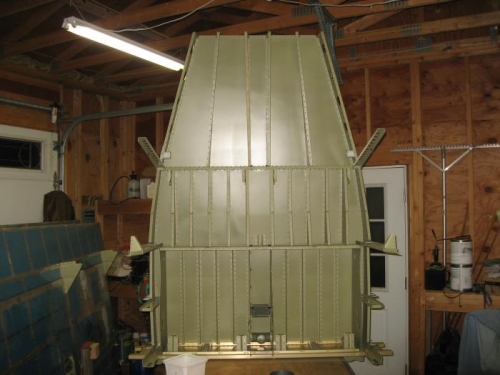

Started riveting the bottom skins. I started with the aft skin as I could set the spar on the floor on a piece of carpet and rivet while standing. After that the spar has to be on the edge of the bench to allow the forward skin to hang down. This is the overlap area that will eventually be covered by a forward bottom skin.
