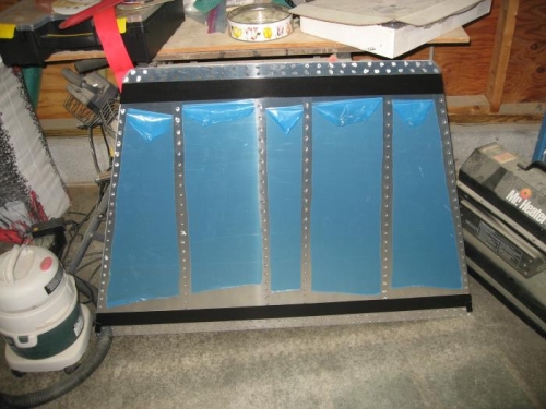

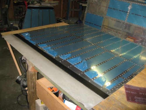

Brief Description:  Bottom skin prep
Finished dimpling the bottom skins and masked off the areas for priming. I always prime the overlap areas so that both surfaces in contact are primed. I mistakenly masked off the aft strip of the aft skin, this will be on the outside and will be painted anyways. I didn't prime that strip.
