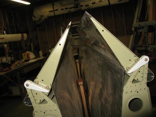

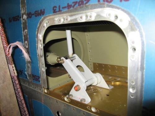

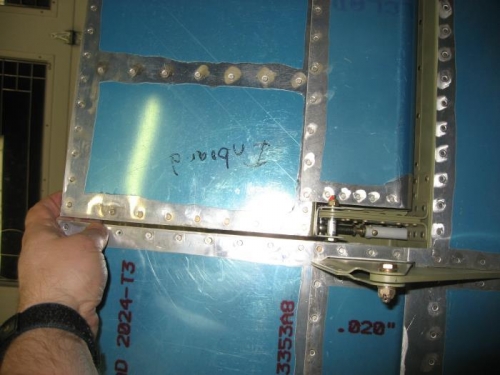

Brief Description:  Aileron installation
Aileron installation, pushrod to bellcrank installation. Adjusted the lengths of the pushrods to get everything aligned in the neutral position using the jig. Based on discussions on the mailing list it looks like this will probably need adjustment after the wings are mounted on the plane anyways.
