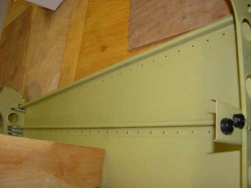

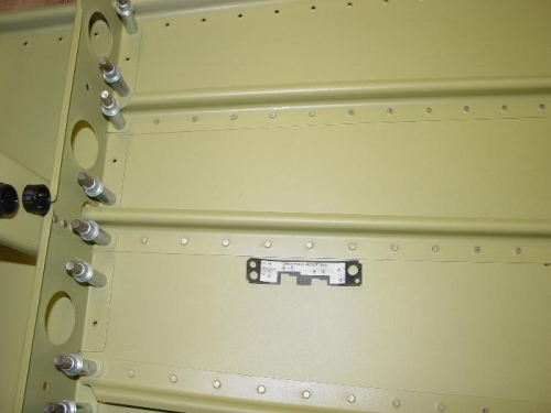

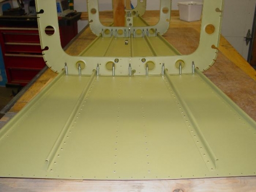

Brief Description:  Tailcone Stiffeners
Started riveting the stiffeners on the forward bottom skin. I did this by back-riveting a small section at a time, sliding the back-riveting plate along as I went. Results were pretty good. The frames have to be in place before the stiffeners are riveted.
