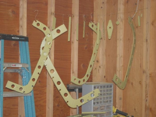

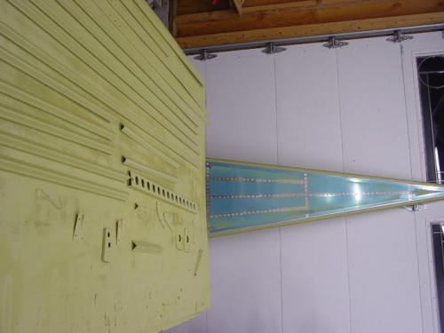

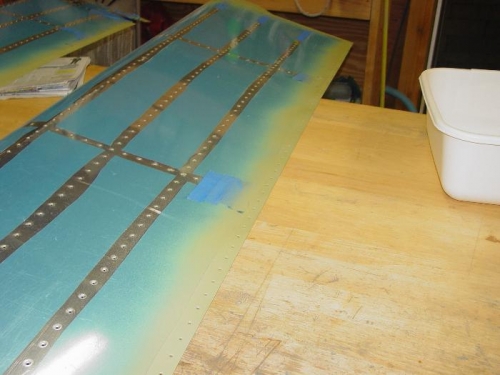

Brief Description:  Tailcone Priming
Finished priming the tailcone parts. I primed the skins where they overlap, so that there won't be any bare metal anywhere. I was mostly concerned about the edges of the forward bottom skin, the edge is rolled to form a stiffener and any moisture in the tailcone could sit down in this area.
