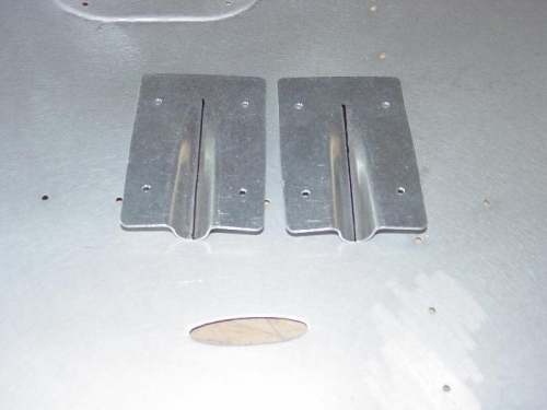

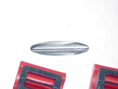

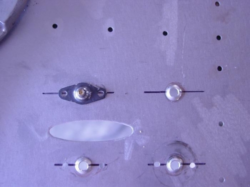

Spent quite a bit of time dimpling skins. Got sick of that and worked on the rudder cable fairings. I drew a line down the middle as shown and used that to align with the elliptical-ish hole in the skin. I aligned the aft end so that it just cover the entire length of the hole. It would look better moved back a little farther, but I am afraid of interference with the cable, since I don't know the angle at which it comes through the hole. I put the F-1011 frame in place to make sure there is no interference at the forward end of the fairing, it looks like plenty of room on that side. I used some K-1100-06 countersunk nutplates for installation so that I will be able to remove the fairing if necessary.
