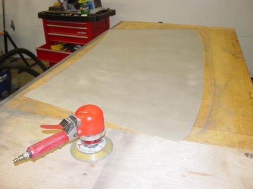

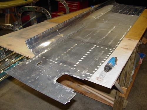

Date:  8-29-2008
Number of Hours:  7.25
Manual Reference:  10-15-4
Brief Description:  Tailcone Deburring and Prep
This entry counts all the time spent during the month of August (not much in total) over about 6 different dates working on the tailcone. All of the disassembly/deburring was completed, and I also started scuffing the skins using the DA sander before dimpling. If you dimple first, the dimples absolutely shred the scotchbrite pad in seconds.
Pictures: DSC03658 - DSC03659
