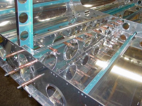

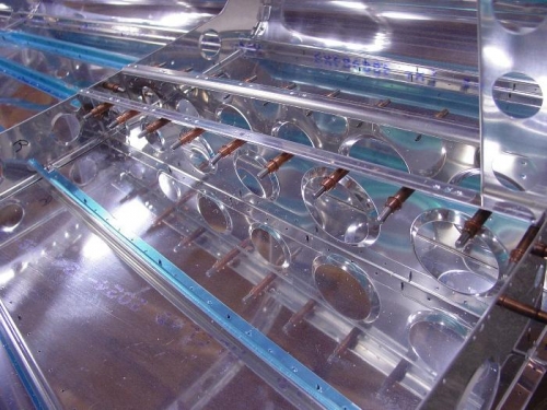

Tailcone Bellcrank Ribs
Fabricated the bellcrank rib angles. Drilled and countersunk the holes for the nutplates. Clecoed the angles to the ribs and final drilled the holes.
Fabricated the 1010B Spacer from the aluminum bar stock.
Pictures: DSC03645 - DSC03646
