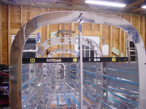

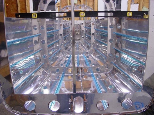

Finished match drilling the side skin to the stiffeners. Fabricated the rudder stop brace and stiffeners and clamped into place. Used the level as shown to verify that there is no twist to the tailcone while drilling the stiffeners to the brace. Match drilled the brace and bulkhead, and also the stiffeners to the brace. You NEED the 12" drill bit for this job, makes it a piece of cake.

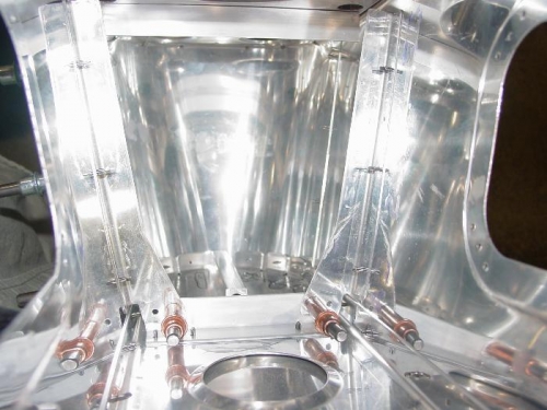

Clecoed the bellcrank ribs to the forward bottom skin as well as the baggage bulkhead channel, and match drilled the appropriate holes.
