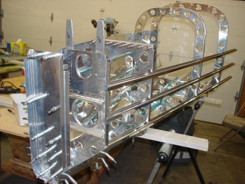

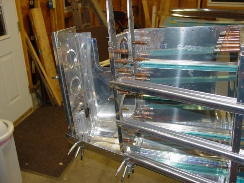

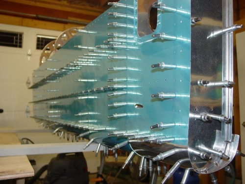

Brief Description:  Tailcone Side Skin
Finished match drilling the left side skin to the stiffeners. Flipped the tailcone and clecoed the aft bulkheads to the skin as well as the aft skin. This was a pain, the aft bottom skin doesn't have the same curvature as the bulkheads and quite a bit of force is required to get it into place. The right side stiffeners were set in place.
