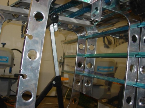

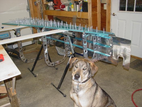

Clecoed the F-1007 and 1008 frames and the F-1010 bulkhead to the bottom skin and inserted the stiffeners. Match drilled the stiffeners to the skin. Clecoed the left skin with the left side stiffeners to the frames, ready to drill the left side stiffeners to the skin.
DSC03635 - DSC03637
