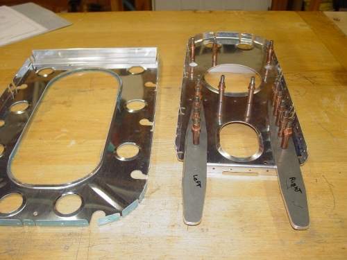

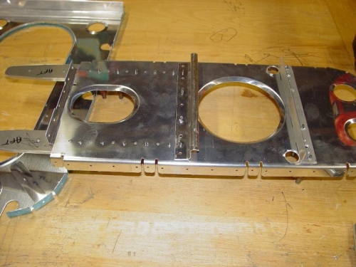

Cut and deburred the F-1011A stiffener. Straightened the HS attachment bars and finished their edges. Attached and final drilled to the F-1011 bulkhead along with the stiffener and rudder cable angle.
Cut out the F-1010A HS attacment angle.
