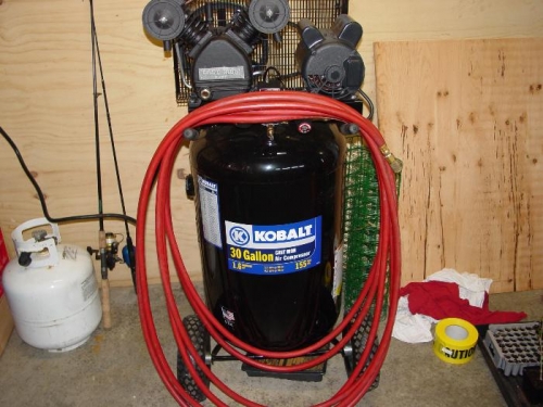

I replaced my old Coleman maintenance-free compressor with this Kobalt from Lowes. Even though the capacity rating is a little lower, it does a great job, and is WAY quieter. The Coleman was really obnoxiously loud, I would never buy another like it.

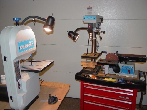

The rest of my tool setup was also purchased at Lowes, got a great deal on the bandsaw. It was the last on the shelf at the time, and was marked down to $72 from $100. The drill press and sander were $100 each, and they work great so far. All three together were cheaper than my rivet squeezer.
