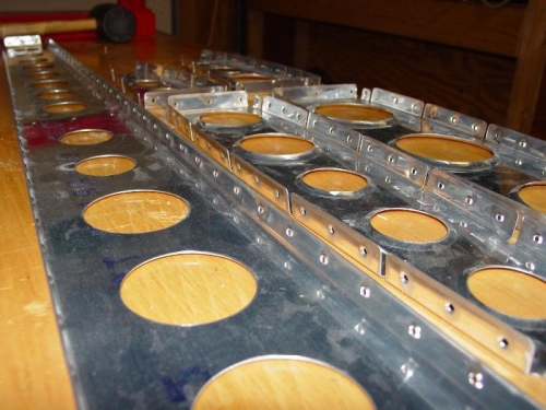

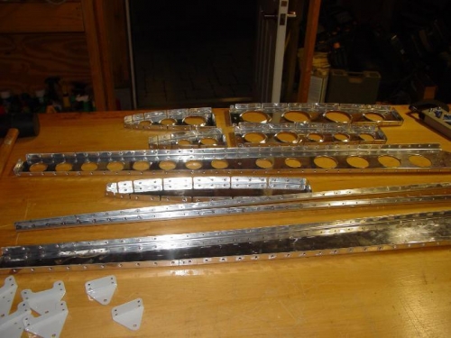

Fixed the accidental 'extra' rivet hole by hammering it out flat. Called Vans and they suggested doing this and filling the hole before painting.
Dimpled all the skin rivet holes on the rib flanges, as well as the front spar. Countersunk the appropriate skin holes in the rear spar and dimpled the rest.
This finishes up this page, I finally get to turn the page!
