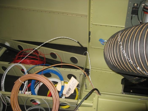

Brief Description:  Tailcone wiring

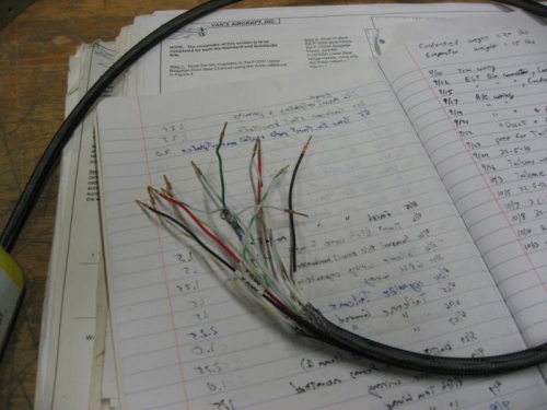

Now that the tailcone is attached the wiring runs can be put in place. The connector from SteinAir needed to be de-pinned so that it could be run through the conduit. The wires are not all labeled but the ones that would otherwise be ambiguous are labeled so there's no worry about putting everything back where it came from.
