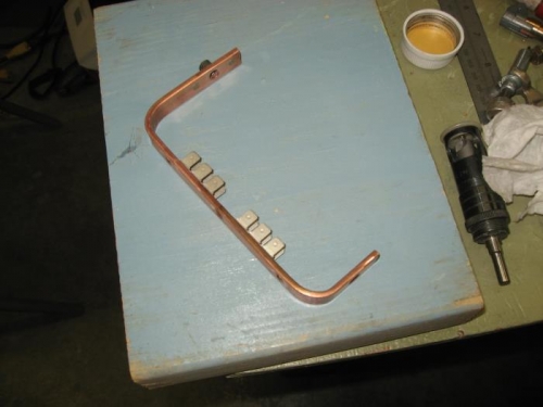

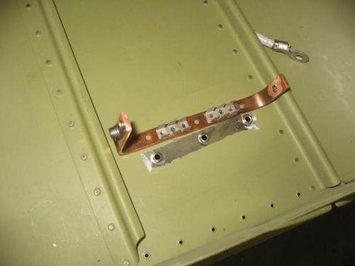

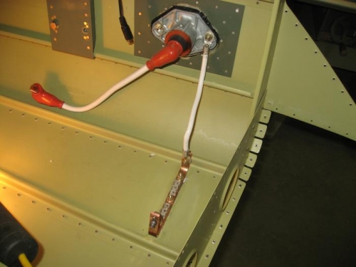

Got the airframe ground put together and mounted in the tailcone. Put some dielectric grease on the bare aluminum to copper interface to hopefully prevent corrosion at that interface. This was tightened down a lot to create a gas-tight interface.
