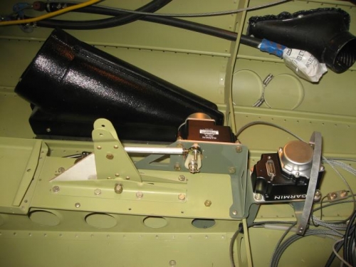

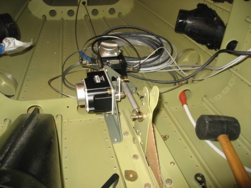

Pitch servo was mounted to adjust the linkage to the elevator pushrod. Luckily I still had the template used to adjust the pushrod length, I used that to position the assembly while adjusting the servo linkage to get the servo arm at top dead center in the elevator neutral position.
Pics: IMG_0984 - IMG_0985.jpg
