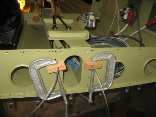

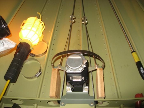

Brief Description:  Yaw damper
Installed the yaw damper bridle to connect to the rudder cables. I had to install the rudder and vertical stabilizer to get the proper alignment with some tension in the rudder cables. The wood block clamps worked great in keeping a little tension in the cables. I don't want there to be any slop in the bridle/rudder cable setup as it seems like that would prevent smooth operation of the yaw damper.
