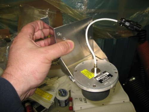

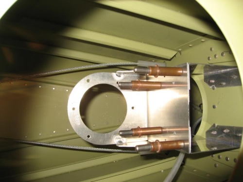

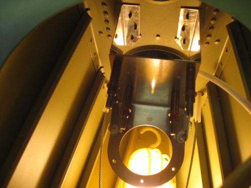

Brief Description:  Magnetometer mount
Created some standoffs to move the magnetometer mount away from the aft bulkhead in the tailcone. This was needed as there wasn't enough space to put the mount directly on the bulkhead, plus it will move the magnetometer away from the elevator horns which are steel.
