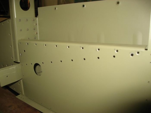

Brief Description:  Fuse side skin dimpling
Dimpling of side skins. Also dimpled the outboard ribs that should have been dimpled before they were installed, but the instructions omitted dimpling those holes. Some of them were not possible to dimple so I ended up using AN470 rivets where they will not show in the wing root. Also broke the #40 dimple die (about the third one on the kit) and had to reorder one.
