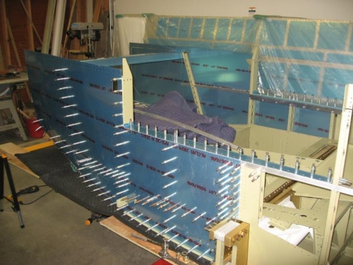

Brief Description:  Fuse side skin drilling.

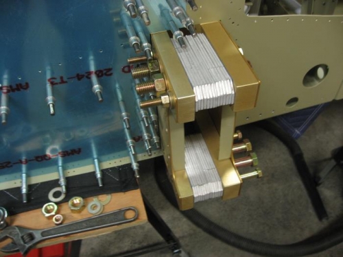

Started drilling the mid side skin on the right side. The temporary spar bolts need to be remove to allow drilling the rivet holes behind them. This was done for the top and bottom separately and the bolts were reinstalled so that the alignment was maintained.
