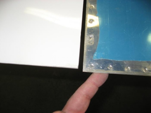

Brief Description:  Wing tip attach
Got set up for installing the tip rib. This really has to be done with the wing horizontal since there is no easy way to clamp the rib into the tip for drilling. This will also allow me to build up the tip on the right wing as it is a little shorter than the aileron.
