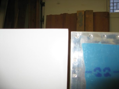

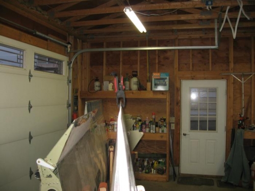

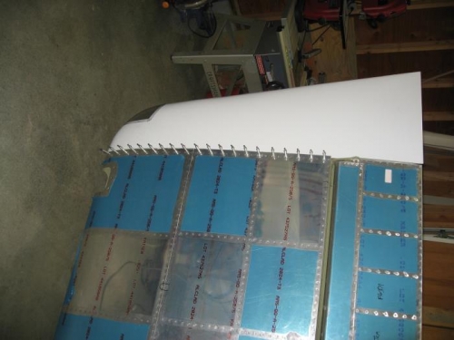

Drilling of right tip to wing. The right wing tip was too long and will need trimming back, the left wing tip is too short and will need building up. Alignment was actually quite easy, but when the wing is hung it may not align as well. Some builders recommend not installing the tips until the wings are on the plane but I don't have the space to do that in my shop, so it gets done now per plans.
