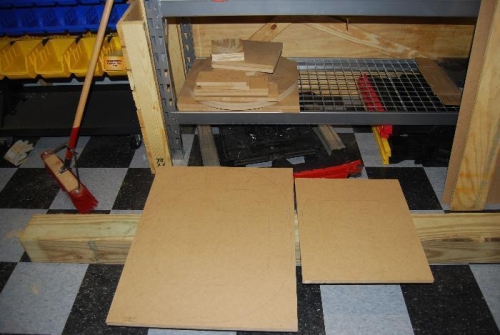

After the succes with Form Block "B", I went ahead and transferred the patterns for the following onto 3/4" MDF: Bulkheads A & C-F, Horizontal (Inboard and Outboard) and Vertical (Top) Stabilizer Ribs. I also transferred the Standard Nose Rib Pattern to a piece of 3/4" plywood and created the second piece. That brings the total patterns transferred to 11 including Bulhead B's that was done yesterday.
MDF w/ Patterns for Form Blocks

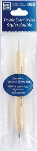

Double Ended Stylus for Transferring Patterns
