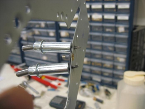

Assembling elevator reinforcement plates
Finished off right elevator final drilling and dissassemble.

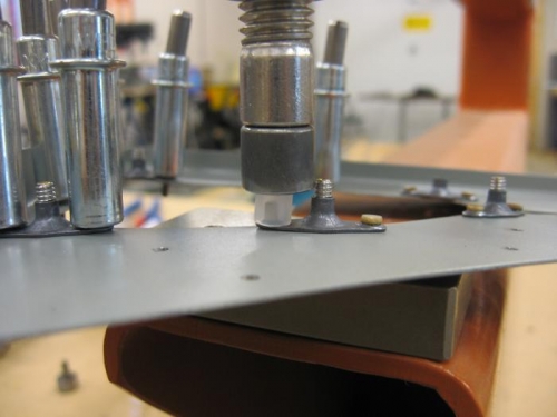

Started assemembling the elevator reinforcement plates with nutplates.

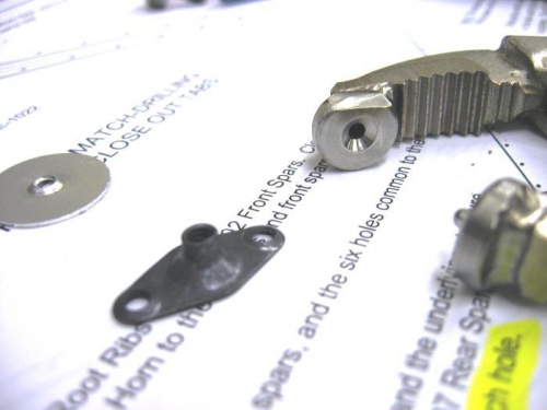

Had to grind down vicegrip dimpler
Used a screw to keep the nutplate in place while rivetting
Used a piece of nylon tubing to press the nutplate down while rivetting
