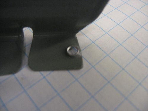

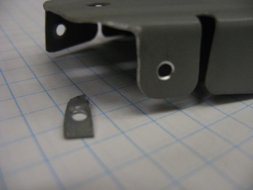

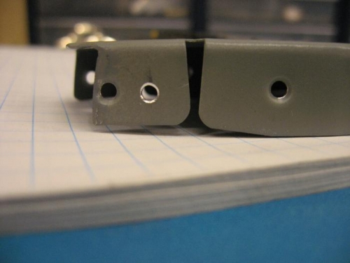

Brief Description:  Fix nose rib edge distance
When I put a radius on the nose ribs, I went too far on one. The edge distance from the hole to the edge of the part was too close. I descided to move the hole over to the center of the flange that remains and cutting off the bad part. The extra hole in the skin will be filled with a rivet.
