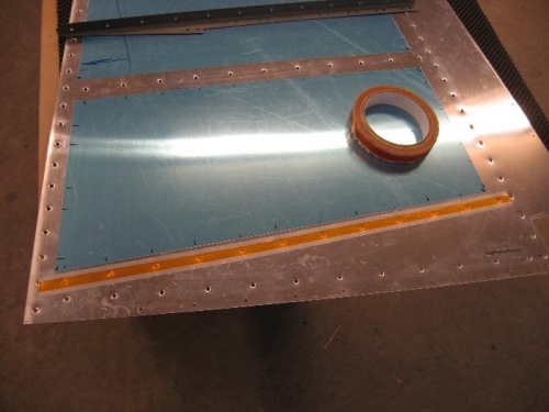

I can see how backrivetting (hitting the rivet on the shop head side as opposed to the manufactured side onto a backriveting plate) can be great, but I will need some practice to get good at it.
Rivet tape to hold rivets when flipping the skin around to backrivet

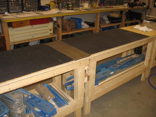

Backrivet backplate setup
Just the right height for the plate and rubber to protect the skins
