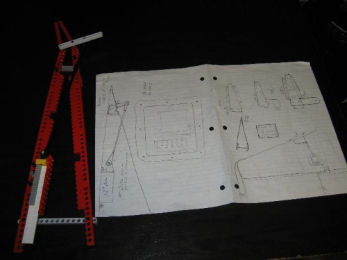

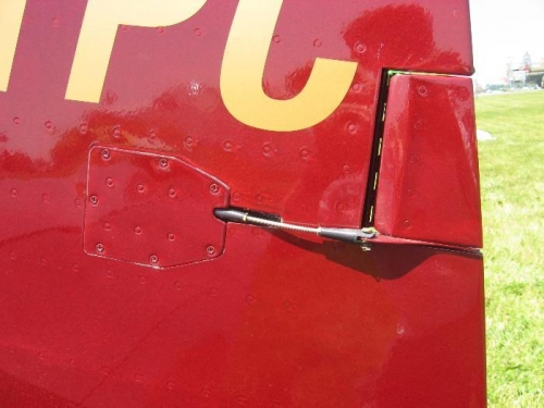

Brief Description:  Designing rudder trim
