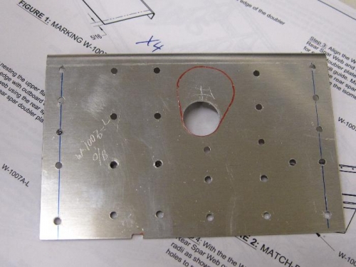

Making aileron pushrod holes in rear spar doublers
I used a step drill to start the hole and my nibbler (meant for hand drill), to rough out the rest of the outline. Filing did the rest.
