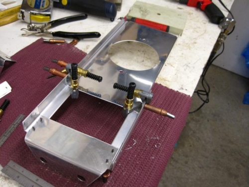

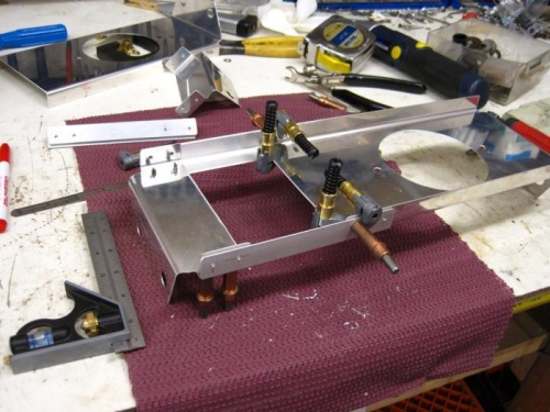

Brief Description:  Landing light mounts
While working on the mounts for the landing lights, I decided to put the angle brackets on the outside of the mounts instead of the inside like the instructions say (and other builders did). This was done to preserve the flanges on the brackets and have more meat to rivet to. Before going ahead with this method, I wanted to make sure that the brackets will still go through the lens cutout in the wing. This meant that I had to cut out the wing holes first and try it.
