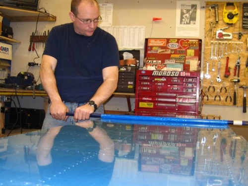

Prepping wing skins

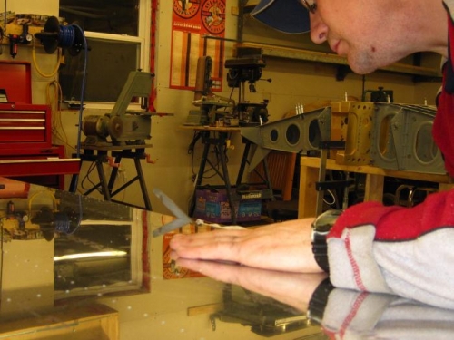

I am not putting a knife edge on the skin that mates on the top of the other skin like some other builders, I plan to put "PRC" (Panel Sealant) on the edge like we do at work on the CP-140 Aurora.
Putting a slight taper on the edge.
peeling off blue protective covering
