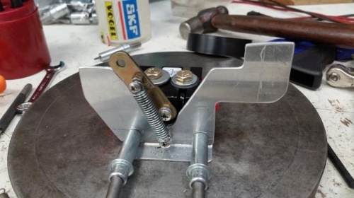

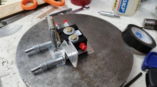

Brief Description:  Brake valve bracket
I wanted to have the valve spring loaded to both the closed and the open position using an "over-center" arrangement. The spring put too much force on the o-rings inside the valve and there was too much friction to make it work. I abandoned the idea for something better...
