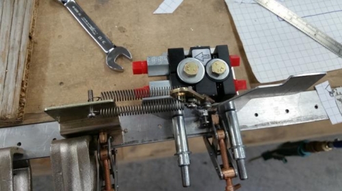

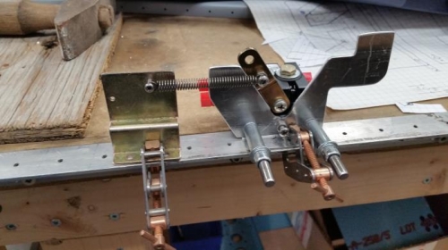

Brake valve bracket
I figured having the valve spring loaded to open would be a better "fail safe" idea. I plan to use an "over-center" handle to hold it closed. I also added a limit switch to indicate when the valve is fully open.
