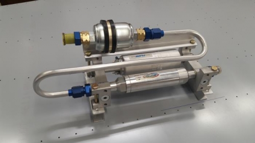

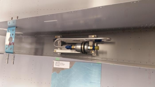

Fuel Pump
I know that most will use the filter from EFII before the boost pump, but I would rather have it after the pump where there is more pressure. I have a pre-filter / gascolator from Aerolab (Flyboy) for each tank before the selector valve.
