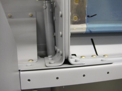

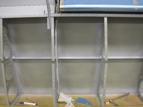

Brief Description:  Aileron actuation (aileron to wing problem)
I noticed that when the aileron is deflected down, the rod hits the side of the hinge. I looked at the geometry and figured that the rod might not hit if the rest of the rigging is in place, but I wanted the rod to actuate in the center of the hole. I put a slight bend in the rod to see what this would do. It cleared the hinge perfectly. If I decide to not have a bend in the rod, I will order the parts from Vans to make a new one.
Rod hits hinge
Rod hits hinge
Deflected up
Deflected up
Deflected down
Deflected down
