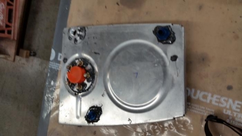

Date:  1-28-2017
Number of Hours:  5.20
Brief Description:  Fuel sender attach hardware
I added a doubler ring to add strength to the fuel qty sender mounts to help eliminate distortion when mounting the fuel sender with the provided rubber gasket. Most say that the fuel senders leak when mounted without sealant. I hope to eliminate sealant.
