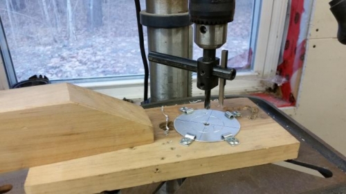

I decided to reinforce the back of the fuel level senders because I hear that the gasket leaks most of the time. I would like to be able to remove the fuel level senders without removing sealant. I decided to make a doubler plate behind the senders and put capped plate nuts for mounting.
