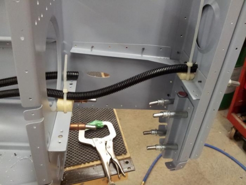

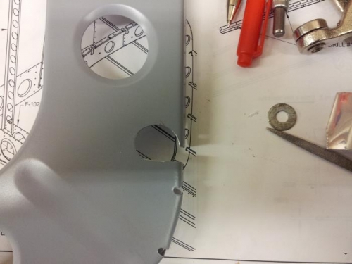

Brief Description:  Tailcone wire run design and disassemble
I decided to run wires in corragated conduit and run that along the J-stiffeners. I will cut away the frames to allow the conduit to go right through. I am making provisions for wire runs on the bottom, top, and both sides.
Opened up for conduit run
