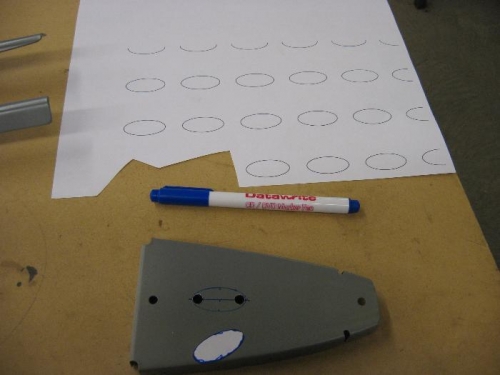

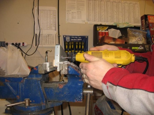

I didn't know how to make an elipse so I drew one on Autocad and printed it out to scale. I traced it and drilled two pilot holes. I removed a bunch more with a unibit and used a dremel tool to finish it off.
Printed with Autocad
