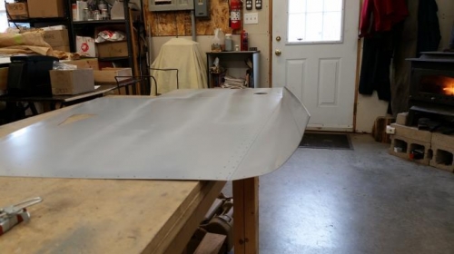

Number of Hours:  6.50
Brief Description:  Fuselage side skins
I found that it is better to fold the front skins further than the instructions indicate. This helps when putting the forward floor skins in. The sides get bowed out which makes the floor not line up with the sides if the side skins are not bent enough.
