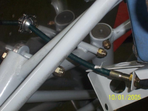

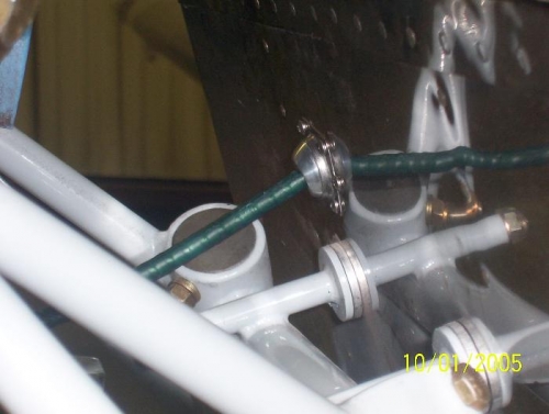

Section 11 Installing engine Date 10/1/05 Today I started the engine installation. I had to turn my airframe around in the hanger and move something's around. I browed an engine hoist and 30 minutes later a had the case bolted on.( the cylinder are out for overhaul) to the engine mount. The first thing to work on was the throttle cable. I used the ball type penetration thru the firewall. I drilled the aluminum ball section to accommodate the cable diameter. (Image)100-0396,100-397 &100-398
