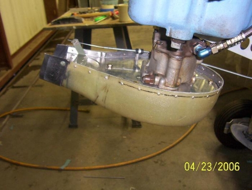

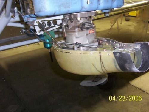

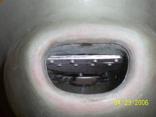

Date 4-23-06 Sec 12I fabricated the alternate air door on the upper surface of the air box. The only change I made was to fabricate a lever for the door. I assemble the hinge and then the upper and lower air box were riveted together. I chose to glue the seal on the lower air bow rather then pop rivet. I am in process of relocating the fiberglass scoop in the lower cowl for a better alignment to the air box.(image) 100-370,100-371 &100-372
