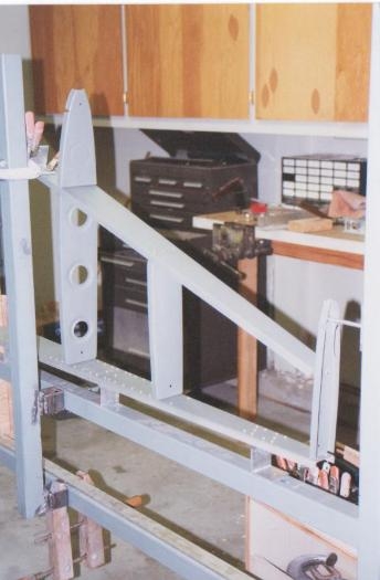

Brief Description:  Assembling Vertical Stab
Chapter 6 Empennage Date 2/15/00 Procedure VS-2 Assembling the Vertical frame was very easy. I used fluting pliers to straighten the flanges of the vertical ribs. I located the ribs on the spars, drilled and clecoed them together. Then disassemble de-burr and prime. Reassemble and rivet all the parts together. (Image) 06
