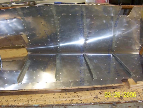

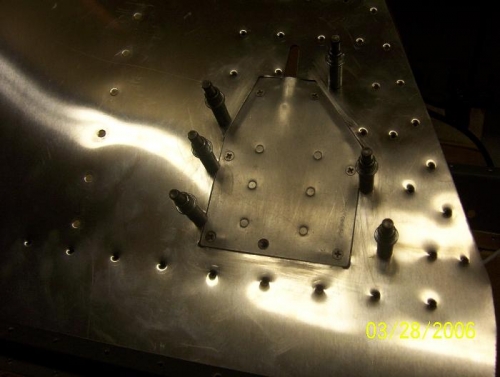

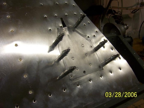

Brief Description:  Re-Build Left Elevator
Section 6 Re-Building left elevator Date 3/28/06After drilling holes I used a C frame with a #40 dimple die set to dimple all the holes . Next I trimmed the skin to the scribe line. The new skin is alcad so I opted to not primer the in side and I started to install the stiffeners on the bottom skin. The servo skin needed to be fit to the new opening in the bottom skin. (Image) 00-0344,00-345 &00-346
