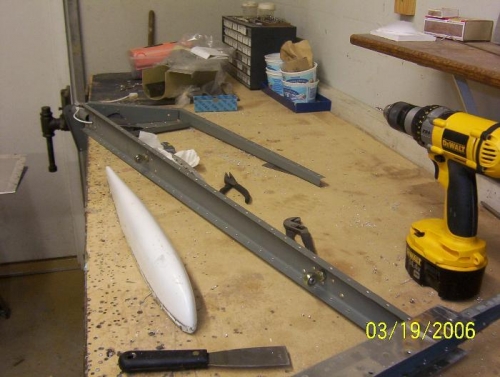

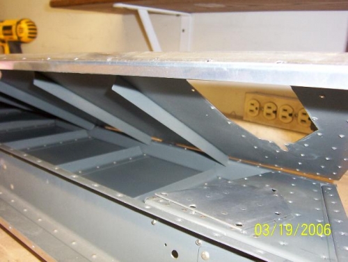

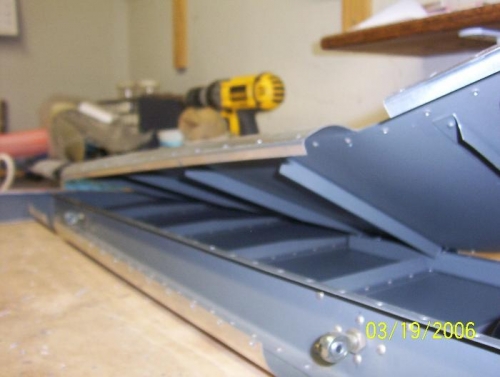

Brief Description:  Re- Build Left Elevator
