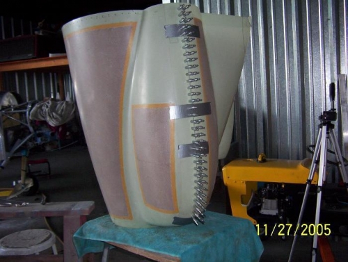

Brief Description:  Cowl Hinges
Sec 12 Date: 11-27-05Today I drilled the hinges and installed the plate behind the spinner. I installed the hinge half in the lower cowl first after locating it with the cowl installed and taped in location. Then I installed the upper hinge half and taped the upper cowl to the lower cowl. After aligning the forward edges of the cowl halves I drilled from the inside and clecoed the hinge to the cowl (Images) 100-446,100-447
