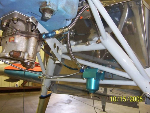

Brief Description:  Gascolator mount
Section 11 Installing engine Date 10/9/05 Today I finished the installation of my gascolator mount and the gascolator. The gascolator mount is my design. The material is 6061-t6 aluminum. I produced it on a Bridgeport mill and I have about 8 hrs. total in its production and design. To minimize cracking of the firewall I used proseal as the sealer between the mount and firewall.
