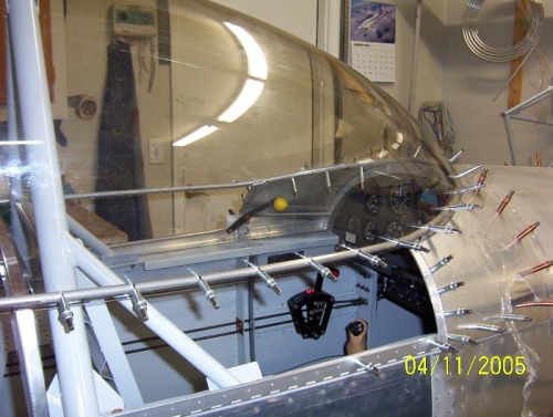

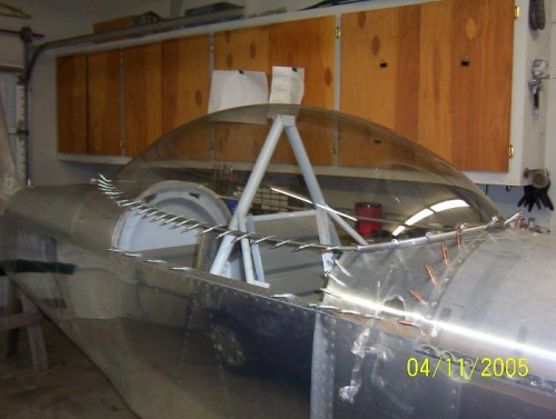

Brief Description:  Canopy Drilling
Section 9 Installing the Canopy Date 4/11/05 The next procedure is to drill thru the canopy into the canopy frame. I accomplish this task with a #40 drill and clecos. I started by clamping the canopy to the frame all the way around the base. The canopy will maintain position to the frame as I drill a hole and replace the clamp with an cleco. After the #40 holes were drilled I removed the canopy and using a unibit I resize the holes in the canopy to 3/16". The holes in the frame were resized to #30 drill for the pop rivet. (Image) 100-0163 100-0164 & 100-0165
